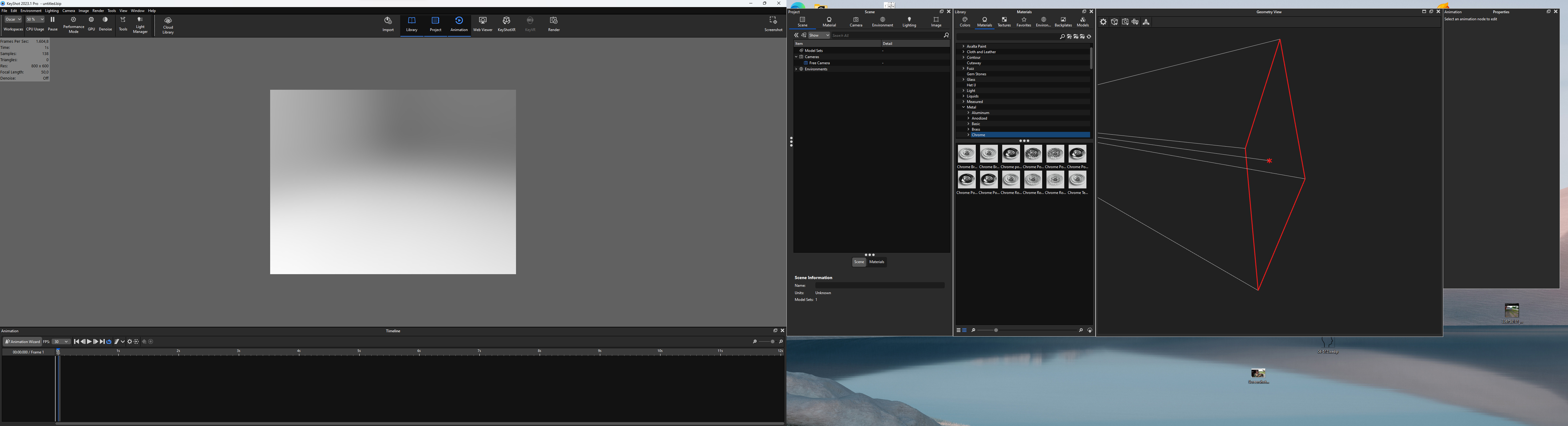

I just created this one, not sure if it will work since I’ve also a monitor at my left and put this on center and right monitor. Closing KS and opening it did leave all in place, well almost, seems the items on the right screen got an extra ‘titlebar’ height of space above them.
It’s the .txt file, remove the .txt for the workspace file. Had to be creative :wink:
My KS is installed ‘Only for Me’ since it’s in AppData/local if you’ve it installed for ‘everyone’ and want to change you of course need to uninstall > reinstall but that won’t take more than 5 minutes I would say. The default save location is the same I think of both versions.
oscar.ksw.txt (2.8 KB)

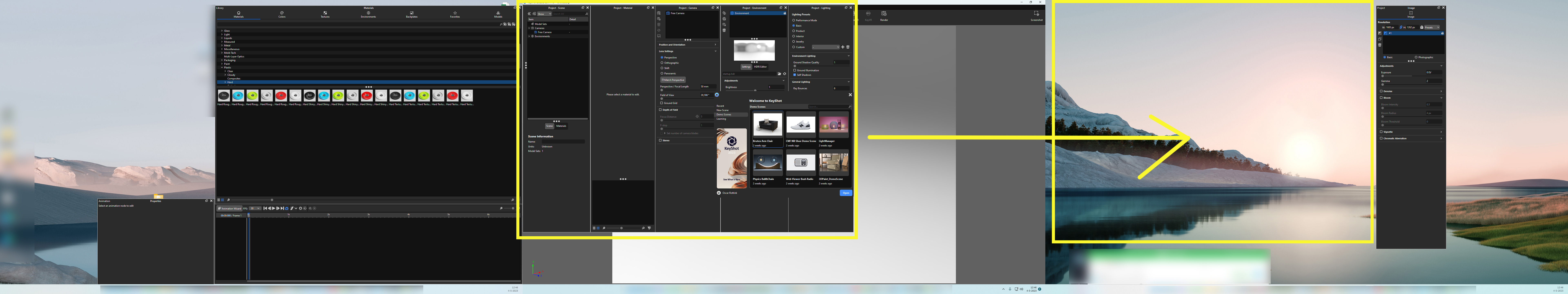

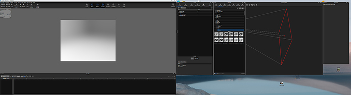

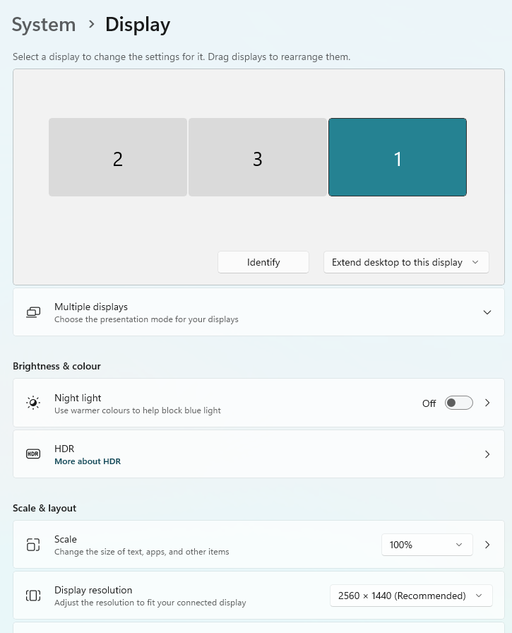

Not sure if your comment also applies to 2023.2 Beta, but here it doesn’t remember it’s workspace. Well, partially it does. The bunch of panels at my centre screen should be at my right screen. This workspace was also created in 2023.2 Beta so no old leftover. All screens have same dimensions as well.
Maybe it has something to do with how the displays are numbered in Windows but that shouldn’t really make a difference I think. Basically that’s just how you’ve your cables plugged into your GPU.
